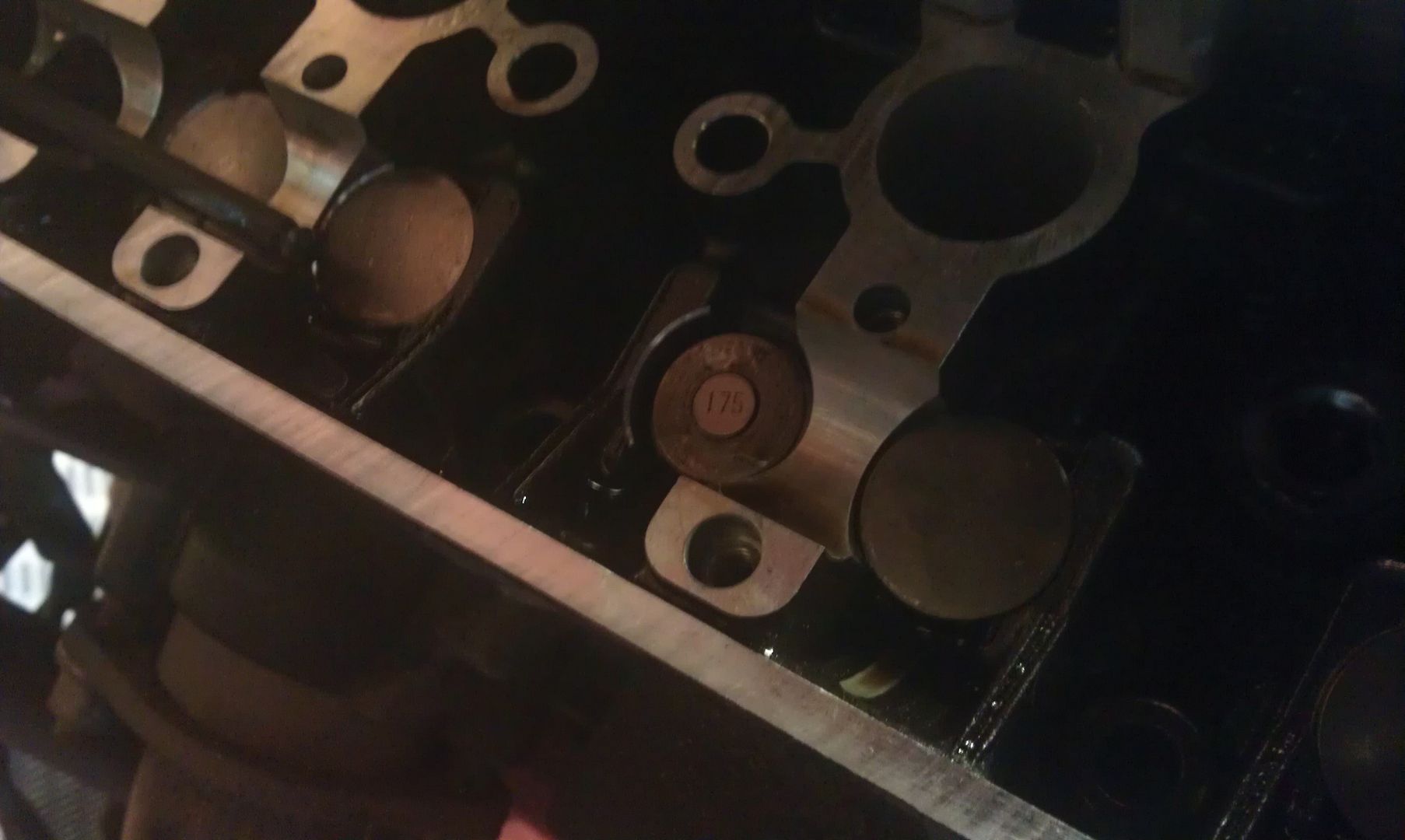

  7. megawatt
    A bit more involved with 20 valves Jay. The shims finally arrived a day late, yesterday, Neil got today off work and I left home at 0645. Woke Neil up, had a brew and bacon butty and then set to work.
    New shims installed on top of valves.
    Buckets checked for lack of shims and refitted.
    Crank position rechecked.
    Exhaust cam reinstalled.
    All done in record time by Neil. Top job mate
